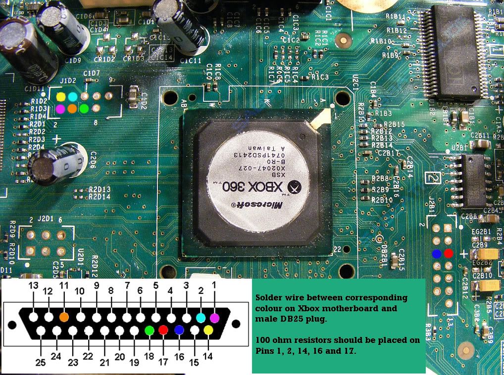

    So I bought my 360 from a friend who doesn't know much about electronics and he had a guy mod it for him and I can't tell if it is JTAGged or not is there a way to tell?

    http://i946.photobucket.com/albums/a...ude2/Final.jpg look at that diagram,you have to look at your motherboard and see if there are wires soldered onto those colored points

    Re: Is there a way to tell if my 360 is JTAGged?
    So if there are wires soldered to those points it is jtagged?
    well if you have wires soldered to those points and those wires lead to a male DB25 plug then yea
    Lol b4 u even open the 360 look at the case there is ALWAYS a plug for the cable that goes to your computer if it is JTagged. if so then open it to make sure there are those wires soldered to those points and do lead to that plug. u can also turn it on and on a jtagged xbox the way it starts is most likely differant then a normal. if the jtag has an xex menu or ur using freeboot. ull know for sure.
